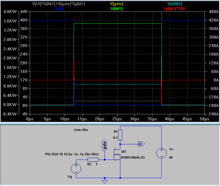

The most common variant for N-channel MOSFET module is low-side switching, that is, switching via the negative line.
Source: Wikimedia Commons, KjellElec, CC BY-SA 4.0
Typical logic:
+24Vfrom power supply goes directly to the load positive.- Load negative goes to the power output of MOSFET module.
- MOSFET module connects or breaks the path from load negative to
GND. GNDof power supply andGNDof controller are connected together.- Controller control pin goes to the
Signal,IN,Gateor similar input of the module.
Common GND / common negative is mandatory. Without it, the controller and MOSFET module do not have a common reference level for the control signal.
Low-side switching has a limitation: MOSFET breaks the load negative. While the switch is off, the load negative is not equal to common GND. For a simple 2-pin fan, strip, or heater this is usually fine. For a load with a tachometer, separate signal wire, sensor inside, or additional connection to another board, you need to check the schematic: sometimes it is better to control the standard input or use a different switching method.
