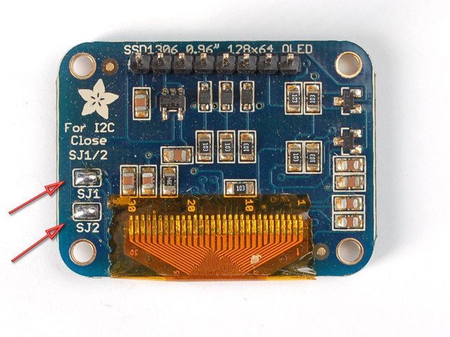

I2C and SPI¶
Small OLED modules usually connect by I2C or SPI.
An I2C module usually has 4 contacts:
VCC;GND;SDA;SCL.
An SPI module usually needs more lines:
VCC;GND;SCK/CLK;MOSI/DIN;CS;DC;- sometimes
RST.
I2C is simpler to wire and usually enough for status, temperature and simple menu. SPI is faster and better if the screen redraws often, but for a small status display this is rarely critical.
Source: Adafruit Learning System, CC BY-SA 3.0
