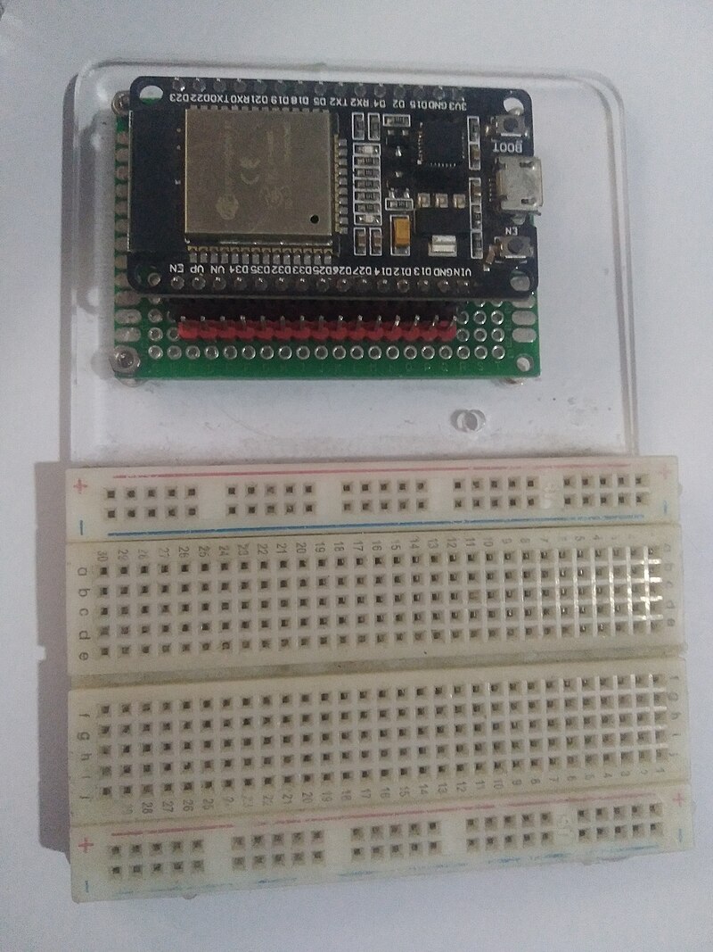

Typical device architecture¶
ESP32 does not power loads directly. It outputs control signals, and separate modules do the power work.
Source: Wikimedia Commons, Edwiyanto, CC BY-SA 4.0
In practice, this looks like:
- ESP32 is powered from USB or stable
5Von the development board; - the ESP32 logic itself runs on
3.3V; - sensors are connected to GPIO, I2C, SPI, UART, or ADC;
- fans, LED strips, DC heaters are connected via MOSFET or driver;
- network heaters are connected only through an appropriate AC SSR/relay and a safe power section;
- servo is powered from a separate
5V/6Vsource, and ESP32 provides only the signal.
GPIO is not a power source for a load. A pin can switch the driver input, but should not power a fan, heater, relay, servo, or LED strip directly.
