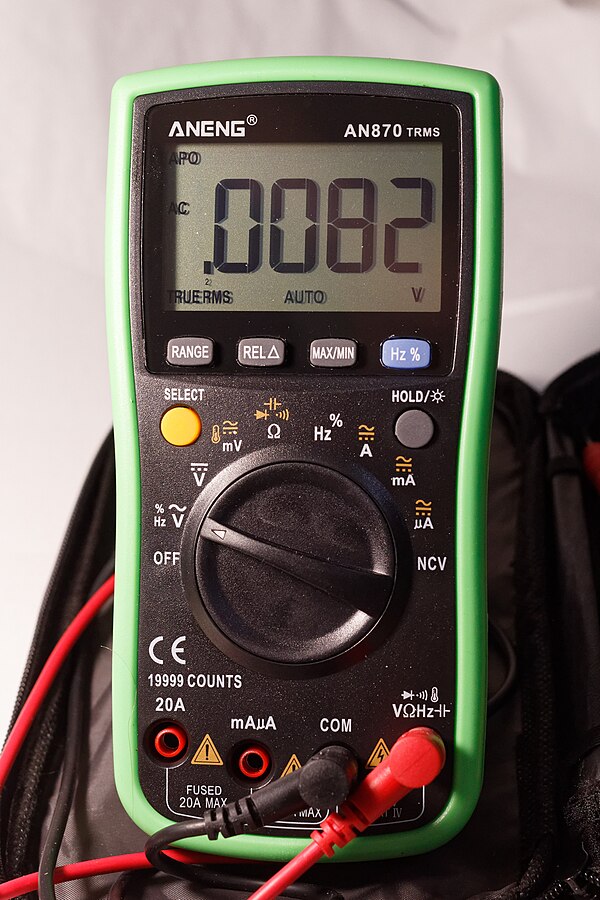

Set your multimeter to resistance mode Ohm.
If your multimeter is not autoranging, select a range above 100 kOhm, such as 200 kOhm or 2 MOhm.
Then:
- Disconnect the thermistor from the board.
- Touch the multimeter probes to the two thermistor wires.
- Do not hold the metal ends of the probes and wires simultaneously: your body can add parallel resistance.
- Wait for the reading to stabilize.
- Record the value.
Source: Wikimedia Commons, Retired electrician, CC0 Public Domain
