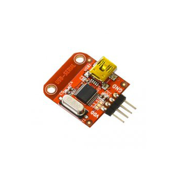

Connection diagram:
Source: Wikimedia Commons, SparkFun Electronics, CC BY 2.0
For simple log reading, TX, RX, and GND are often sufficient. Power is only connected if it is clear the board should be powered from the adapter.
