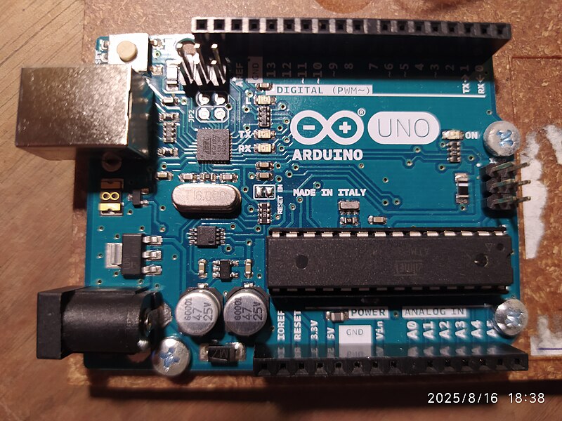

Uno and Nano in a nutshell¶
Classic Arduino Uno and Nano are usually based on ATmega328P.
Typical characteristics:
5Vlogic;- 16 MHz clock;
- 32 KB flash memory;
- 2 KB SRAM;
- 14 digital pins;
- 6 PWM pins on Uno/Nano class;
- 6 analog inputs on Uno, 8 on Nano;
- USB for flashing and powering the board.
This is enough for educational sketches and simple standalone tasks, but not enough for complex logic, networking, web interface, large libraries, and convenient integration with modern systems.
