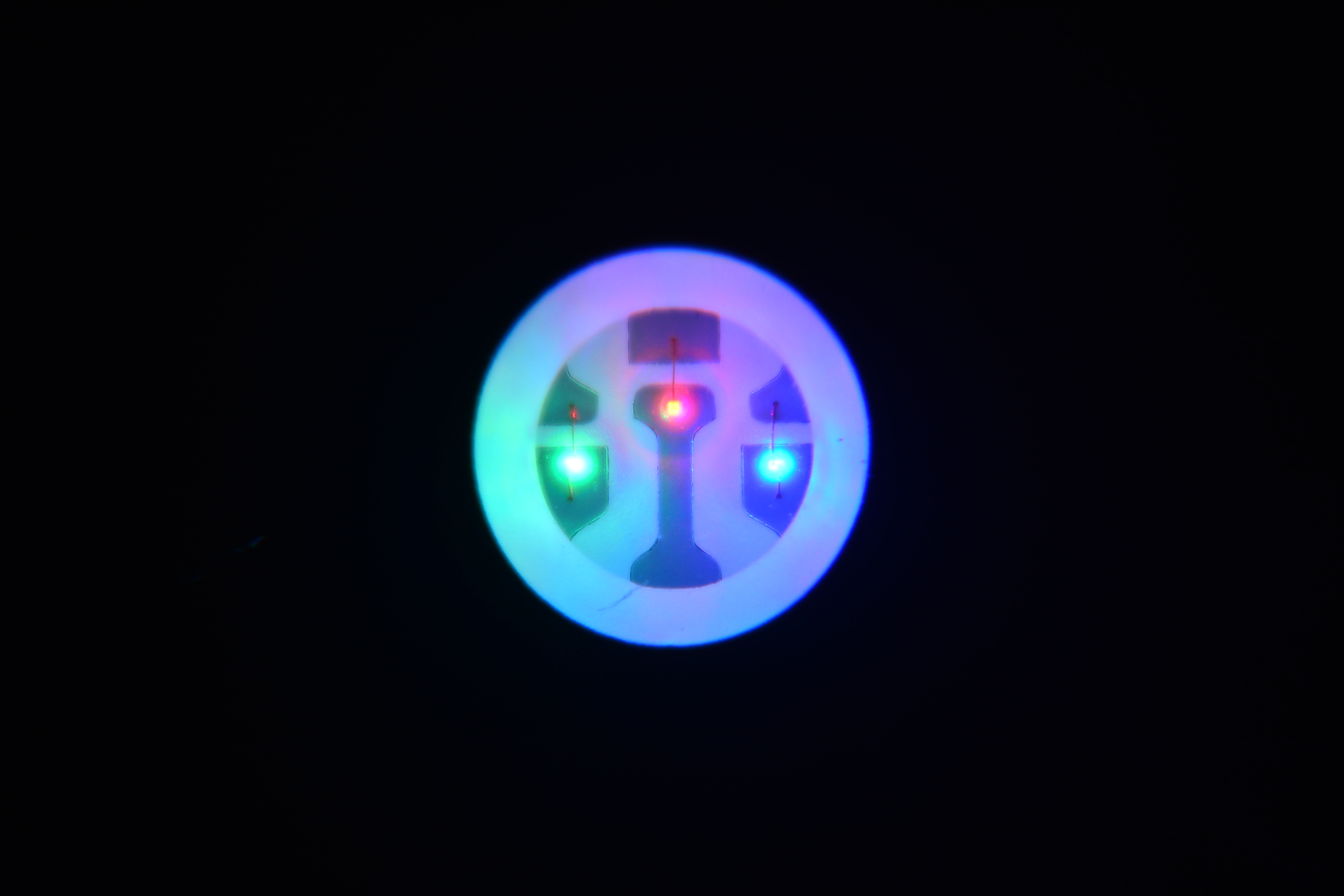

Connecting a Simple Single-Color Strip¶
For a white 12V or 24V strip, a low-side MOSFET is often used: the strip's plus is connected to the power plus, and the strip's minus is switched by the MOSFET module.
Source: Wikimedia Commons, Akbermamps, CC BY 4.0
