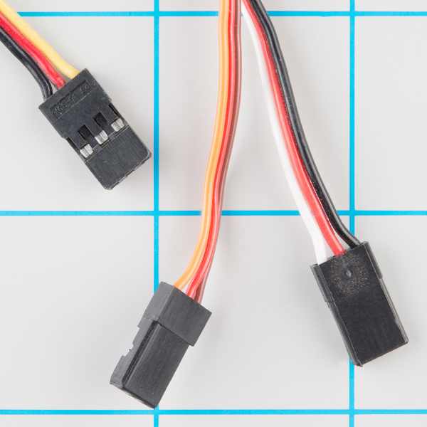

Common colors:
- red - power;
- black or brown - ground;
- yellow, orange, or white - signal.
But you cannot blindly trust colors. Different manufacturers may use different color schemes. Before connecting, check the marking, product page, or datasheet.

Source: SparkFun Electronics, CC BY-SA 4.0
