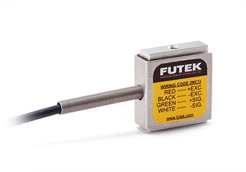

Mechanics Matter More Than Circuit¶
A load cell must deform exactly as the manufacturer intended. If the load goes around the working zone, the cell will show unstable readings or almost nothing.
Source: Wikimedia Commons, FUTEK Advanced Sensor Technology, CC BY-SA 4.0
For a beam cell, the typical idea is:
- one side is firmly mounted to a fixed base;
- other side carries a platform or load;
- there's clearance between the moving part and base;
- screws and case don't block beam bending.
