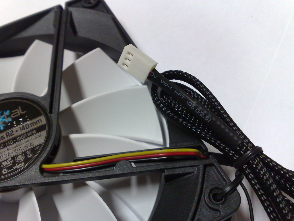

Fans often differ in the number of wires.
Source: Wikimedia Commons, Dsimic, CC BY-SA 4.0
2-pin:
+V;GND.
Such a fan simply gets power. You can control speed by changing supply voltage or PWM on the power line if the board and fan support it.
3-pin:
+V;GND;- tachometric signal (
tach/sense).
The third wire usually outputs a speed signal. It doesn't control speed by itself.
4-pin PWM:
GND;+V;- tachometric signal (
tach/sense); - PWM control signal.
On a 4-pin PWM fan, power is usually supplied constantly, and speed is set by a separate PWM line. This is not the same as rapidly switching the fan power on and off.
