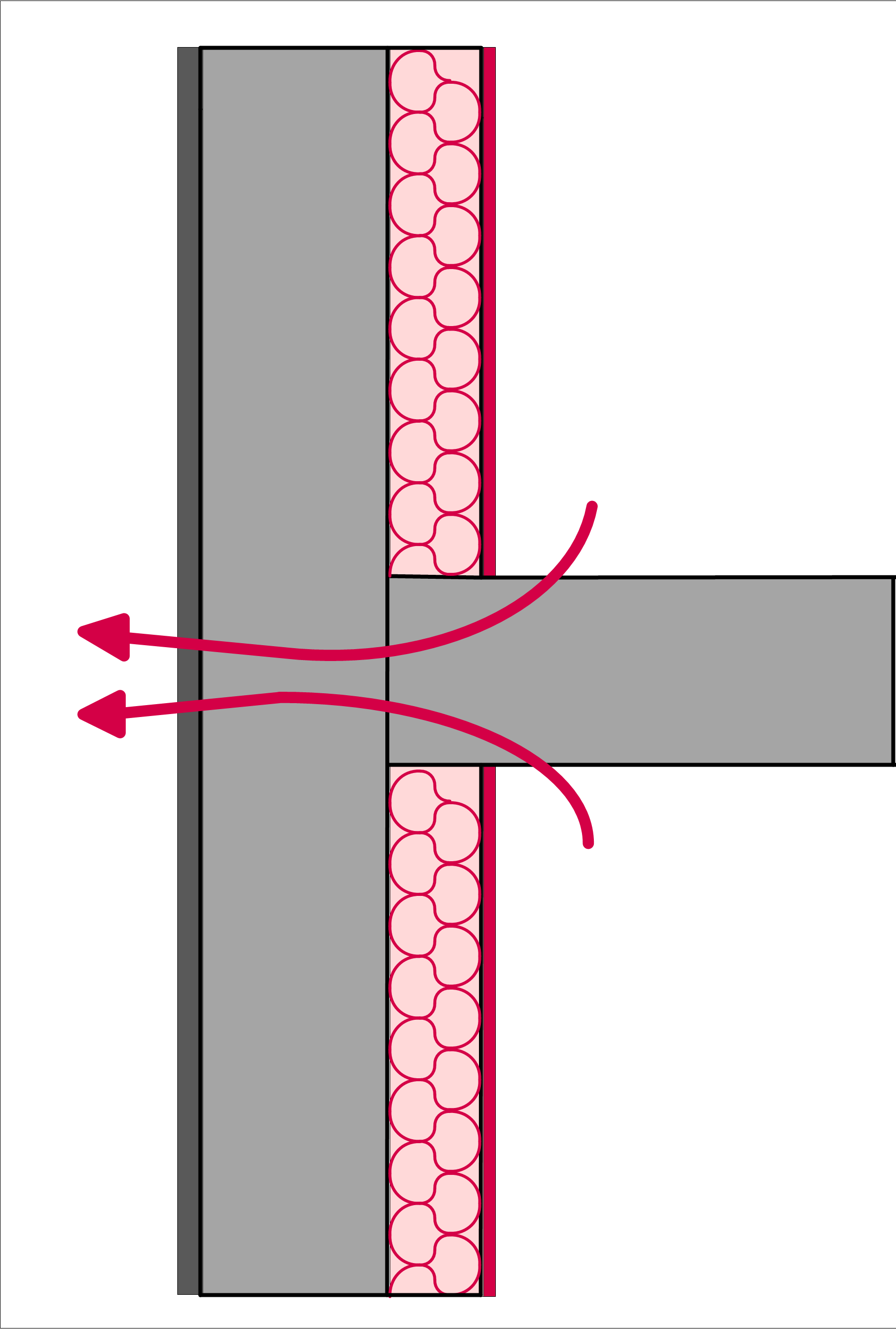

Thermal Bridge¶
A thermal bridge is a path through which heat escapes more easily than through the rest of the structure.
Source: Wikimedia Commons, AmisDeLaThermique, CC BY-SA 3.0
Typical thermal bridges:
- metal screw through an insulated wall;
- aluminum plate connected to the outer housing;
- metal post between hot chamber and outer panel;
- terminal block or fastener near the heater;
- air duct that directly touches a hot part.
A thermal bridge is not always bad. Sometimes it is needed to dissipate heat from a power switch, radiator, or hot node. The problem starts when the bridge is accidental: the chamber loses heat, the outer surface becomes hot, and plastic near the bridge heats up more than expected.
