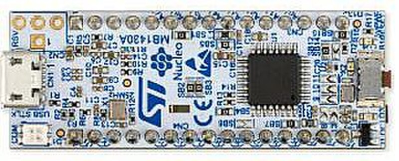

Source: Wikimedia Commons, Avandalen, CC BY-SA 4.0
The Klipper host runs on a Linux device, and the STM32 board physically controls pins: switches MOSFET outputs, reads thermistors, controls fans, receives limit switch signals, and communicates with the host via USB, UART, or CAN.

Nucleo, Blue Pill, and printer boards¶
STM32 Nucleo boards are convenient for learning and prototyping. They usually have a built-in ST-LINK, Arduino Uno V3 connectors, and ST morpho pins that provide access to more signals. This is a good option if you want to learn STM32 and have an official flashing tool.
