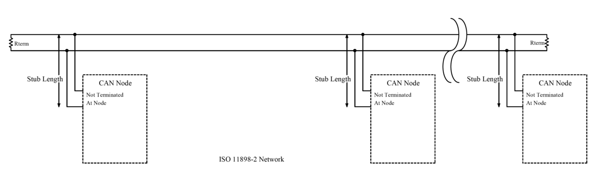

CANH, CANL, and GND¶
A physical CAN bus typically uses:
CANH;CANL;- sometimes
GNDor common reference wire; - module power separately, if needed.
Signal is transmitted as the difference between CANH and CANL. That's why CAN handles noise better than single signal lines.
Simplified diagram:
Source: Wikimedia Commons, EE JRW, CC BY-SA 4.0
For wiring, a twisted pair is often used for CANH/CANL. GND depends on the specific circuit, boards, and documentation, but in small DIY systems, a common reference is often needed for stable operation and interface safety.

Topology and terminators¶
CAN is a bus. Good topology looks like a line with nodes attached via short branches.
Usually two 120 Ohm terminators are needed:
- one at one physical end of the bus;
- second at the other physical end.
Not one, not three, and not "on each board". Exactly two at the ends.
If power is off, on a properly terminated bus, a multimeter between CANH and CANL often shows around 60 Ohm, because two 120 Ohm resistors are in parallel.
Many boards have a terminator jumper. Some have a built-in terminator without convenient disable. So before assembly, check the schematics of all boards on the bus.
