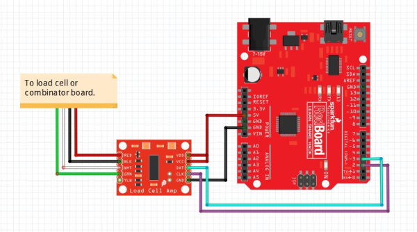

How the connection is arranged¶
Load cell connects to HX711 with analog wires.
HX711 connects to the controller with digital wires.
Typical chain:
The HX711 usually has two sides:
- input from load cell:
E+,E-,A+,A-, or similar; - connection to controller:
VCC,GND,DT/DOUT,SCK/CLK.

Connecting HX711 to the controller¶
On the controller side, you usually need four lines:
VCC- module power;GND- common negative;DT,DOUT, orDATA- data;SCK,CLK, orPD_SCK- clock.
For many HX711 modules, power can be 3.3V or 5V, but check the specific module. If the controller runs on 3.3V, it is convenient to use a module and power compatible with 3.3V logic.
Pins DT and SCK can usually connect to regular GPIO. This is not I2C or SPI in the usual sense, but a simple two-wire HX711 interface.
