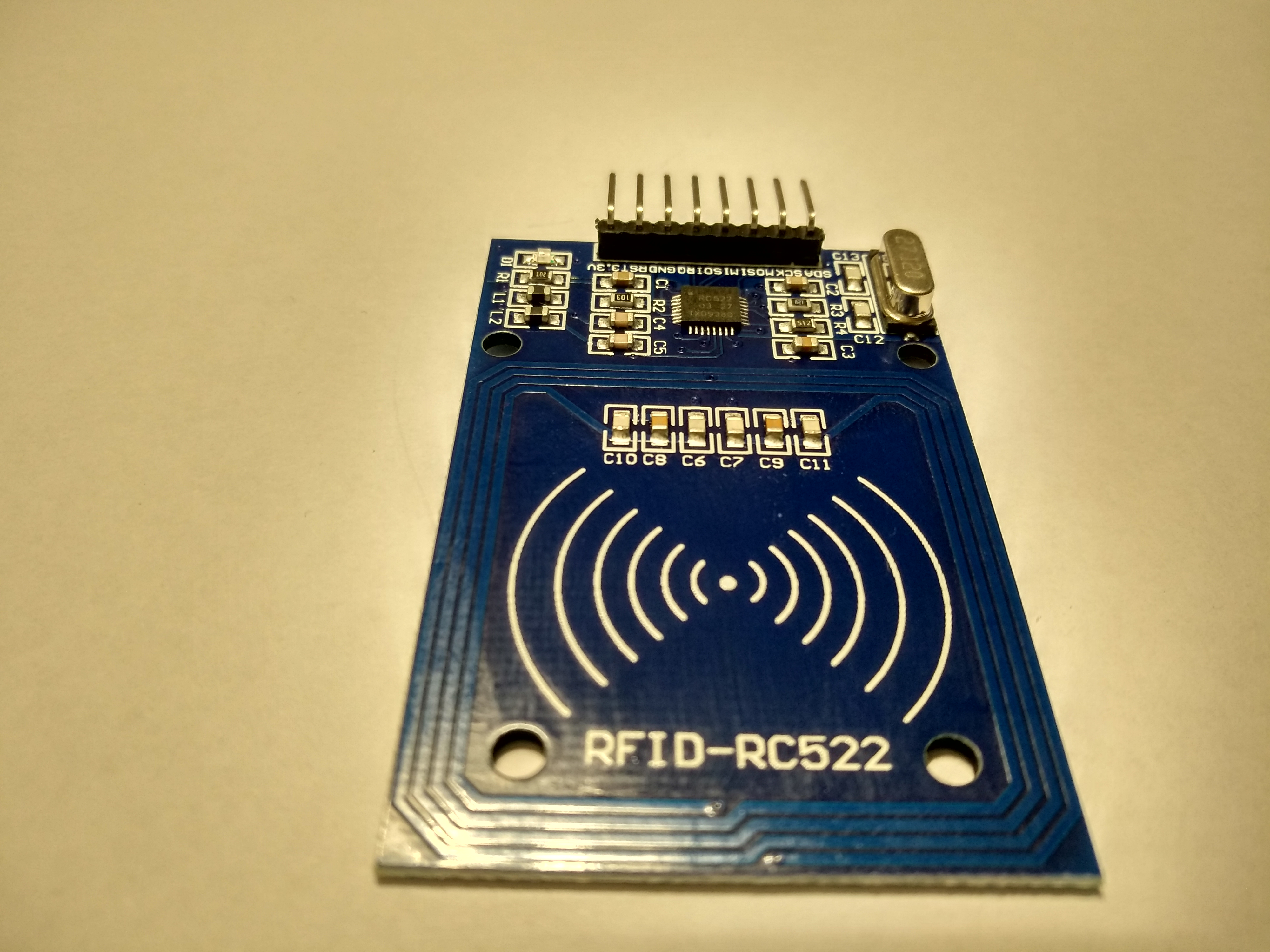

RC522: typical SPI connection¶
Cheap RC522 modules usually run on 3.3V and most commonly connect via SPI.
Typical lines:
VCC-3.3Vpower;GND- ground;SCK- SPI clock signal;MOSI- data from controller to module;MISO- data from module to controller;SDA,SS, orCS- SPI chip select;RST- reset;IRQ- interrupt, often unused in simple projects.
Source: Wikimedia Commons, Giacomo Alessandroni, CC BY-SA 4.0
Pin names can differ. For example, on RC522, pin SDA often means SS/CS for SPI, not the I2C SDA line. This is a common source of confusion.
